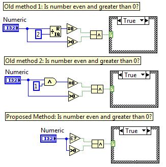

I tend to use the Quotient and Remainder for determining whether a number is even or odd. It clutters up the block diagram with the primitive, a constant, and a comparison.  How about one (or two) of those nifty little triangles with a number in and a boolean out to indicate if the number is even (or odd)?  It seems I need this function more frequently than one would expect, and it would be a simple 'new feature'.

Instead of Quotiend&Remainder, I simply do a bitwise AND with a diagram constant of 1. The result is either 0 (=even) or 1 (=odd). You can wire this directly to a case (and make the cases 0 and 1) or add a "=0" or "!=0" of you want a boolean.
Wrap it into a subVI if needed.

I've used the AND approach as well. I just really have an affinity for the triangles, I guess 😉

Picture time...
Primitive example...
