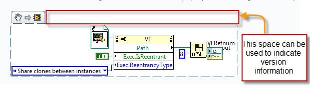

It would be usefull to include information in the header of the image to indicate which version of LabVIEW was used to create the snippet. Users running older LabVIEW versions will not be able to embed the snippet onto their diagram.
To avoid localization issues, I suggest just using a simple numeric indicator: 2009, 2010, 2011 etc. Another option is to use a watermark.
