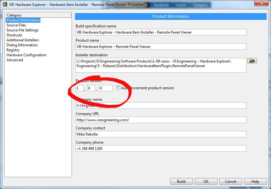

When building, the version fields are limited to being I8 - I want them to be strings:
22290i709C7BD2DB9CC86E
This means I can't have a version like "2010" or "8.2 f3".

It would still be useful to define for each field whether or not it's a number, so the auto incremementing still works.
Also, an I8 seems like a very limited choice. I would say it should be at least a U8, if not U16. I may not run through versions that fast, but it's nice to have the option. I certainly do have executables which are updated with minor features and bugfixes relatively often.

I agree that I8 is an unnecessary limitation, however I really hope that they stick to numbers. We should all adhere to a standard here to make it understandable for everyone how different versions relate to eachother etc. Allowing a string input will result in a mess.
Using the year as a version number is a weak (marketing based) idea. I think the feedback to NI when they introduced LV2009 showed a consensus about that. On the other hand I can understand why others will follow when that's what users get used to, but please - just put it in the name of the application, not the version number.

Are you sure it's an I8 and not a U16? It seems that the number is limited by the OS (for windows)

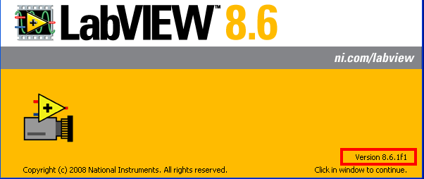

National Instruments doesn't even adhere to that standard.  For example, I'm running LabVIEW 8.6.1f1

I doubt that you are actually running 8.6.1f1, does the version number of the executable mention 8.6.f1 as well? (it's in the properties page of the executable file), my executable file version is 8.6.0.4001 for LabVIEW 8.6.1:
22330i339402850D277A52
This means the major version is 8, minor 6, bug 0 and build 4001
The build number you can set in a executable builder is shown here.
The number Crelf mentions is set in the application builder and is used by Windows to determine whether the application needs to be upgraded. Allowing non-numerics into the version is a nightmare for comparison. What is bigger: 4.1a or 4.a1 or 4.A1 or 4.1A?

Oh, I guess you're right.  I just assumed this
22332iA61D89F13801BE25
was the actual version number, not just what it's called.

Did I say an I8?  Oops!  I mean that it's a U8 🙂

I'd be okay with just numbers, but I need something larger than a U8, especially in the first and last fields.

That sounds like a ridiculous limitation U8 instead of U16.
