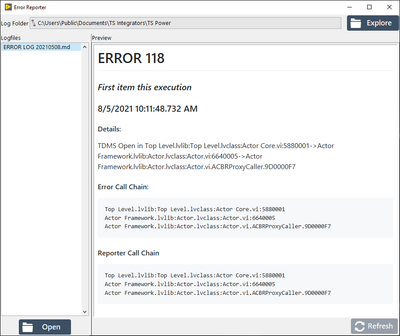

  • reporting of errors through a global collector as you suggest, an event or something similar.  LabVIEW should ship out of box with an error reporter window similar to MGI's markdown logger panel that would monitor the global collector and launch on new errors or when opened by the user (behavior definable programmatically).  I'm not sure that the ability to see multiple error files in one window is needed, but I love the readability of MGI's markdown formatted error log.  I would add the "possible reason(s)" if possible to the error log though.  That is often helpful.
MGI's Markdown Logger Panel:

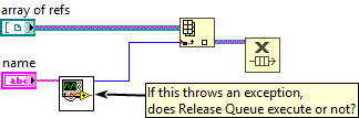

Here's one fun diagram we debated a lot.

If that VI threw an error, then it should not be outputting a usable index (so probably -1), but unfortunately it is probably outputting the default value for the data type, 0, which will close the wrong ref.  In this case, and I'd say in all cases, the developer is responsible for managing how exceptions are handled in downstream code.  In that case (in all cases?), they should be using case structures to decide what portion of downstream code is executed.
I don't think we are asking to change the error handling paradigm, just the error reporting paradigm.  It is still up to the developer to catch and handle errors in the data flow as needed.  What would be nice is if LV supported a general error reporting system without having to resort to all the third party reporting solutions which are all based on dropping error reporting vis all over the various block diagrams.

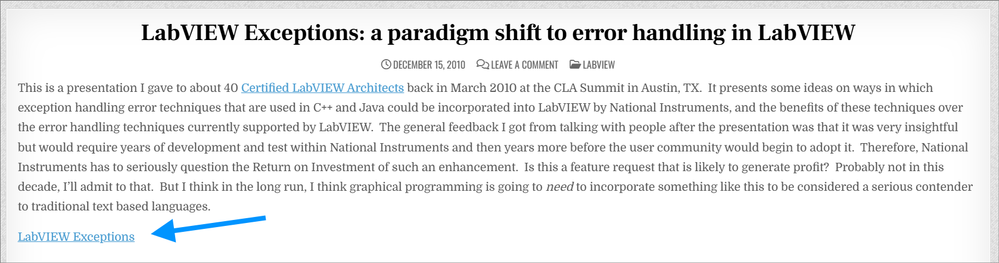

1. For an excellent discussion of how throwing exceptions in LabVIEW could or should look like, and the benefits that exceptions would offer, please see the LabVIEW Exceptions: a paradigm shift to error handling in LabVIEW presentation that Nate Moehring delivered at the CLA Summit 2010: https://www.themoehrings.com/index.php/2010/12/labview-exceptions-a-paradigm-shift-to-error-handling...
The direct link to the PDF slides: https://www.themoehrings.com/wp-content/uploads/2010/12/LabVIEW-Exceptions.pdf
