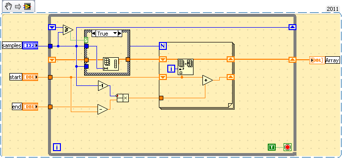

It seems to be borne out by this not-so-clever VI (about 4 times longer for the G Ramp than for the C Ramp). But it becomes measurable (in ticks) only above 10^4 elements... So what is the need of the C Ramp, really, except for convenience? Let have the Open G people implement a G Ramp and that will be it.
PS: the weird structure comes from my clumsy attempt to optimize the timing performance. I also used this as a "Subroutine" VI just to be on the safe side.

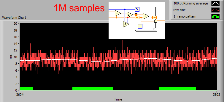

Well, I don't know why you add so much code! 😮 For 1M samples, my simple version is within 5% of the stock Ramp Pattern, in fact you would be hard pressed to see a difference unless you look at the 100pt running average shown in white.
The green trace indicates which version is active.
On the same benchmark, your version is about 2x slower.

I (te)bow to that Smiley Very Happy. The conclusion is the same: no need for the ramp VI... or for a new function for that matter.

New machine since I last checked. On my Quad Core, homemade is not far off. Still a factor of 3-4 on the old laptop. New CLFN with parallel code smokes both. The absolute times are not too shabby for most uses.
