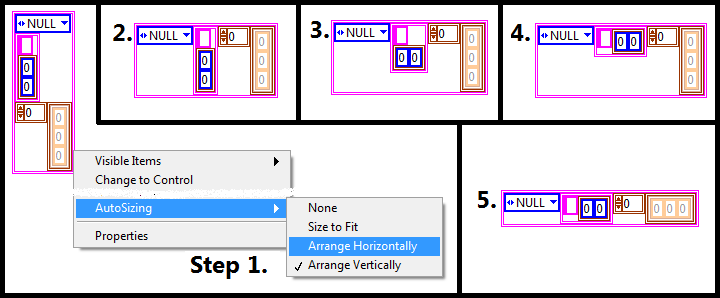

Going from a purely vertical to a purely horizontal arrangement for clusters can be laborious. It's necessary to find the sweet spot on each 3 pixel border and navigate through two levels of context menus for each nested element:

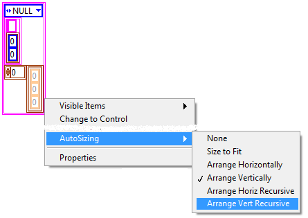

It would save time to be able to recursively choose the cluster arrangement:
