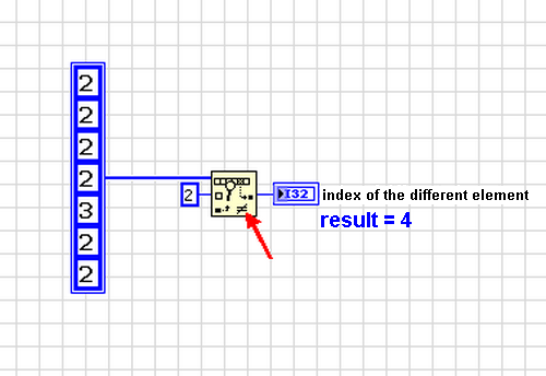

a possible improvement for the "search 1D function"
The current function searches for an element identical to the input element.
It would be useful to be able to do the opposite :
            Search 1D Array : be able to search a different element
a new function or ...
the current function with an option to select : "the same element", or "a different element".
and why not (It would be also useful) an additional output with this different element.

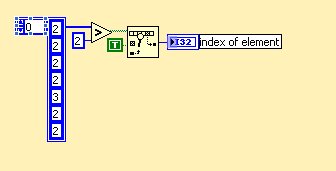

I probably would use this rather than a loop:
But this being said, I think that the comment that this is a rarely used search occurence is probably why you won't get much traction for this "logical" suggestion.

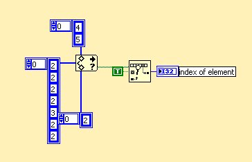

For instance, search whether an element is larger or smaller than a particular value (would also be applicable to array of clusters), or within a range, as a variant of the diagram above:
I had fun with the last diagram. Can you guess what results it returns?
Can you guess what results it returns?  Smiley Happy
include upper limit ? (y/n)
include lower limit ? (y/n)

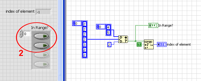

2 2 array X [0] [4 (array upper[0])   =  false
2 ]  2 array X [1] [ 5 (array upper[1])   =  false
Search 1D Array (False,False) for "True" ... result = -1

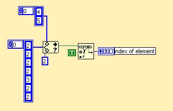

Yes, I was sort of suprised that after having wired a single scalar to the lower limit, the created constant for the upper one turned out to be an array.
The "In range?" array in the example above has a the dimension of the "Upper Limit" array.
What I was aiming for was this:
which returns the expected index (4).

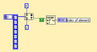

I still do not get the multiple array bounds usefulness:
returns -1 as well. but the important message is that the Boolean array result is of size 1, i.e. the minimum size of both the upper and lower limit arrays.

1 ?   i don't understand ... my result below (LV2013)

Yes, because you have only one array in this example. If you replace the lower scalar by a single element array, it will return a single element Boolean array.
I am sure there is a clever use case for this, I just can't think of one.
