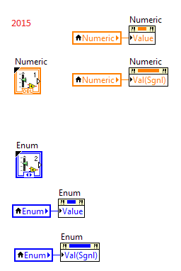

The CAR is marked as fixed in LV 2012.
I just verified in LV 2015. Works just fine.
AristosQueue (NI)
NI Employee (retired)
And the Find CAR appears to also be fixed. Also in 2012.

You might well be right, but I am correct too.
Here is what I have on my diagram:
The local variable corresponds to the PN's control. Notice the red coercion dot.
1) If I force recompilation (Ctrl+ Run Arrow), nothing happens.
2) If I disconnect the local variable and try to reconnect it to the PN, nothing happens. I mean nothing. I CAN'T get a wire to connect the two.
3) If I Ctrl-Z all this, here is what I get:
No coercion dot. This VI has been recompitled dozens of time since I upgraded to 2015.
Edit: of course the control is a typedef.
AristosQueue (NI)
Works fine for me. I tried directly in 2015. I also tried creating a problem case in 2011 and then loading it in 2015. It mutates correctly.
I guess there must be something corrupt about your particular VI. Delete the control and re-drop it and see if the problem goes away.
