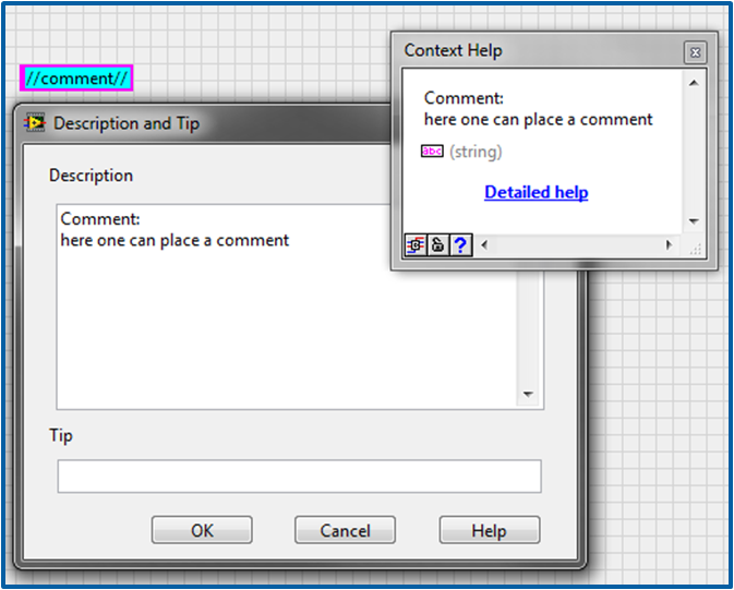

Place a string constant to your code and add the code comment to the "Description and Tip" of this constant.
After that you can see your comment in the Context Help

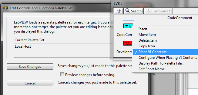

If you put this string constant in a VI and store it somewhere on your harddisk you could add it to your favorite tools palette for instance (select in the "Edit Controls and Functions Palette the "Place VI contents"). Capture.PNG
After that add it to QuickDrop and you should be good to go...
