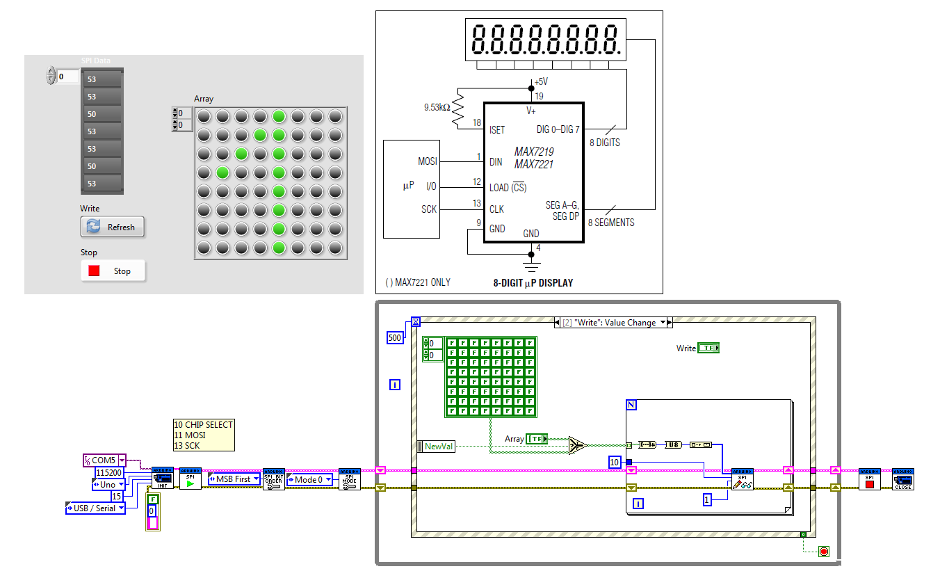

My objective is to be able to write (turn on) 1 or more indicators (on the matrix) dynamically.
is this done using SPI in my scenario. I know there are Vcc, GND, Din, Cs, and SCK
clk and cs I have them connected to DIO 52 & 53, Din I have it connected to DIO 12
but iam struggling into conceiving the spi part.
again any help will be appreaciated.

I changed to the arduino UNO.
DIN --> pin 10
CS --> pin 11
CLK-->pin 13

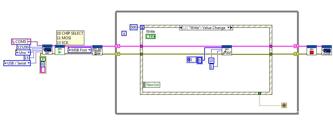

here is the code I have
Iam writing 1 byte at the time (every event). all it does is make the LED brighter.
say I wanted to make letter A light on the matrix.
Again any help will be appreaciated.

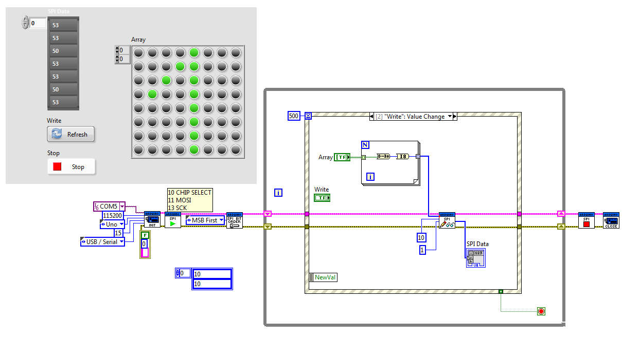

Iam thinking about having a 2D array boolians that I can set up dynamically and converting that into something that I can write to the ship and hence turn on the appropiates output.
I just cant make the matrix plash the way I want to.
Iam I going through the right path here?

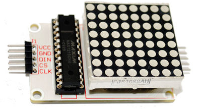

If you could post a link to where you purchased it and possibly example Arduino (or other) example code, it would help.  I didn't study the datasheet extensively but I could only find reference to 7 segment LEDs which only had options to display numbers and specific letters for a 7 segment LED which won't work for the LED array.
Message 6 of 10
(8,614 Views)
thanks for the replay.
I dont have a link for the little matrix board. (it looks exactly like the one on the picture. (has I/Os including reference and vcc.

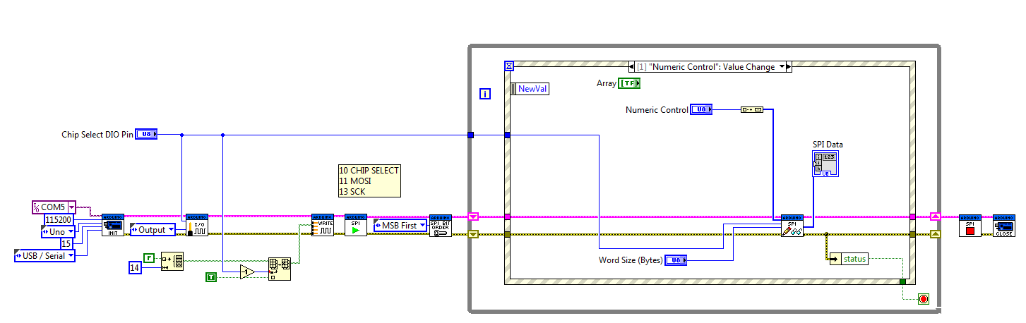

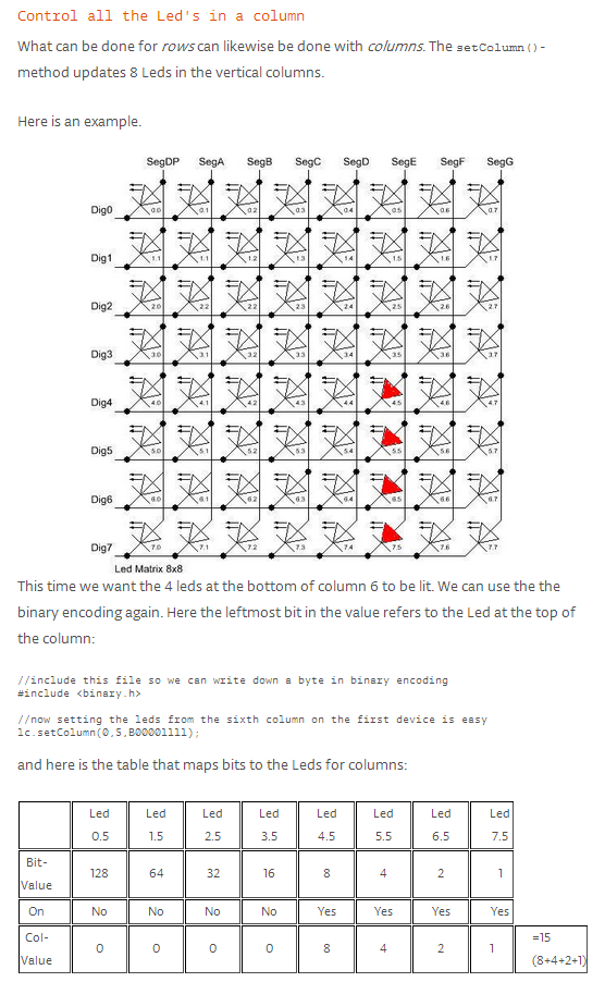

http://playground.arduino.cc/LEDMatrix/Max7219 this is a sample code for a matrix control.
here is another example: http://playground.arduino.cc/Main/LedControl here is exactly what i want (on the matrix control)
they call the row, colum of the given led(s) to display and then they write the binary value example:
I cant seem to achieve this on my scenario.

iam here trying to just write 1 byte representing the top row on my 2d array just to see something.
output spi data is always = 53.
the actual array iam not using it rather the numeric control to simulate a 1d array = to row0

Hi!
Some days ago I get two of this Matrix, and at the beggining I also think that the MAX7219 (due that this product mix a 8*8 matrix and the MAX7219) worked in the same way that have 2 74HC595, I mean: 8 bits for control columns, and 8 bits for the control of the rows. But that it's not right, the MAX7219 work with 16 bits, but like Nathan says, this is a driver for control 7 segments displays, not a LED matrix, and also has some other features that depend of the Data that you send to it. You can't send 8 bits for the columns and 8 bits for the rows, because the distribution of the data for the MAX is the next:Data.png
Taking this table and other stuffs from the Datsheet I made a LabVIEW code that already work and in which I show how the driver works: https://decibel.ni.com/content/docs/DOC-36277
