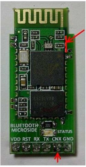

How can i sinc with arduino mega 2560 with this module. I have tried to do it but nothing. I followed the steps described here
this is my bluetooth module HC05
on init.vi i choose for connection type, the bluesmirf bluetooth. i dont know how to make this module to work because it isn't in LIFA.

That guides seems to be very thorough.  There is a list of things at the bottom of the guide to check if it doesn't work.  Did you go through those?
You mention choosing the connection type on Init.vi but it is much more important make sure the COM port (VISA Resource) matches the COM port listed in your device manager for the Bluetooth connection and that your baud rate matches the Arduino firmware.  I think they have the Arduino Mega defaulting to 9600 in LIFA version 2.1.1.69.
