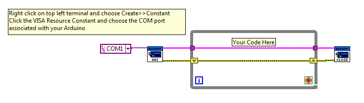

3) only thing i don't know how to explict wire in COM port for the Arduino Init VI
so any one suggest me to find solution for my problem .

Please also provide more details about your problem.  There are many reasons you could see error 5005 so we need a lot more information about what you are trying to do and what troubleshooting steps you have tried to resolve the issue.  For example, can you see the Arduino in windows device manager (are you using windows?) what version of LIFA and the Arduino IDE are you using?  Did you get any build errors when trying to deploy firmware to the Arduino (did you deploy firmware to the arduino?)  Did you modify the firmware in any way?  What baud rate are you using?  Did you explicitly wire in a COM port for the Arduino Init VI?

And my follow up:
Hope this helps
-Sam K
