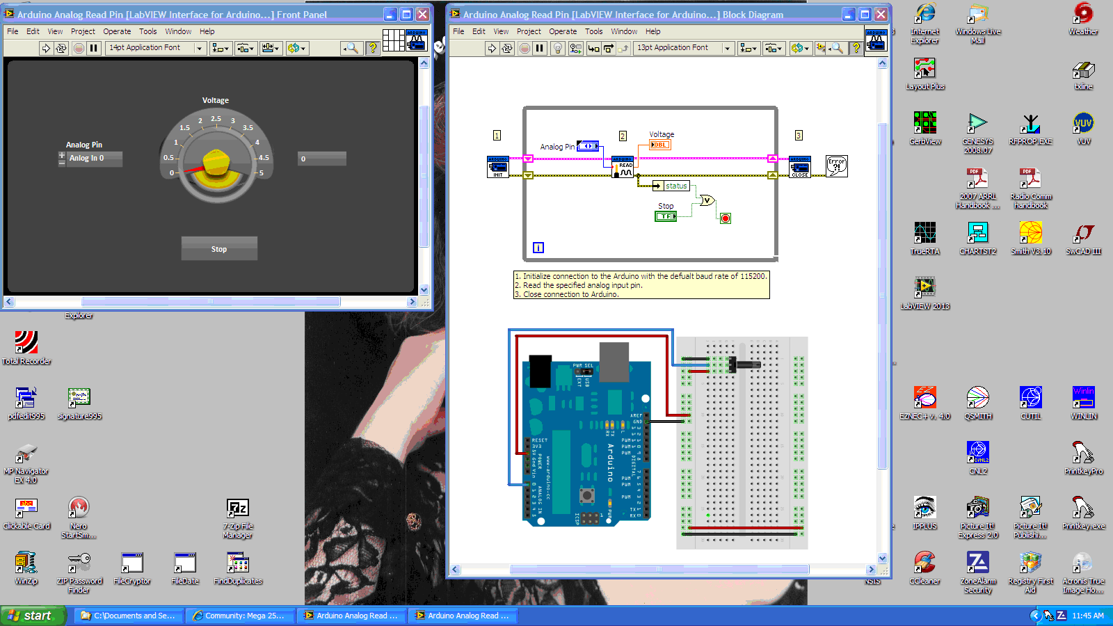

I am completely new to Labview and Arduinp. I have loaded the Labview interface for Arduino and the examples.
I need some serious help here. When I try to communicate eith Arduino using the USB, the read LED flashes
- then I get a 5005 - Unable to find Arduino error
Here is a picture of the VI
The init.vi says its a Board Type (Uno) however when I right click on properties - i get a blank box that says 'apperance'
also, could you define what a VISA is? Thanks

VISA is the driver used for serial communication.
Which Arduino are you using?
Does the Arduino show up in the Windows device manager?
Are you able to connect to the Arduino via the Arduino IDE?
If the Arduino is assigned a COM port successfully, you can try to wire a constant to the VISA resource input of Init.vi so that it doesn't need to search for it.
