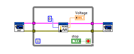

I think we need to get the basic questions out of the way to make sure that we are on the same page.
Are you using the latest version of LIFA?  If no, then you should upgrade to the latest version and make sure that you get the new version of the firmware and upload it to you board.
Next, here is how a basic program using LIFA should look:
It is important that you always use the Close.vi when working with Arduino.  Never use the "abort execution" button.  Close.vi must run to avoid issues.
Init.vi defaults to an UNO with a 115200 baud rate (this is how the firmware will default for an Uno) and will automatically search for the correct COM port.
So,  upgrade to the latest version of LIFA and uploade an unmodified version of the firmware then create a VI as shown above.  This should get your desired results.  If it is unable to find the Arduino, add the COM port constant back to Init.vi and try again.  If it still does not work then there may be bigger issues.
Also, make sure that you are able to run the Blink example in LabVIEW.  That will tell you if there is something more fundamental wrong with your setup.
