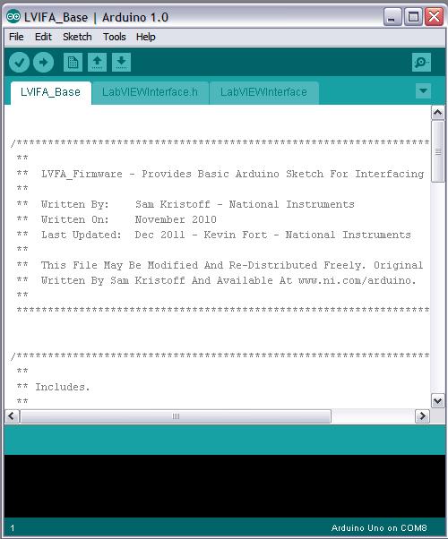

I must be doing something stupidly wrong; when I upload the "LVIFA base2" to the Arduino, I get the following errors:
In file included from LVIFA_Base.cpp:157:
LabVIEWInterface.h:34: error: redefinition of 'unsigned char currentCommand [15]'
LabVIEWInterface.h:34: error: 'unsigned char currentCommand [15]' previously declared here
LabVIEWInterface.h:36: error: redefinition of 'unsigned char acqMode'
LabVIEWInterface.h:36: error: 'unsigned char acqMode' previously declared here
LabVIEWInterface.h:37: error: redefinition of 'unsigned char contAcqPin'
LabVIEWInterface.h:37: error: 'unsigned char contAcqPin' previously declared here
LabVIEWInterface.h:38: error: redefinition of 'float contAcqSpeed'
LabVIEWInterface.h:38: error: 'float contAcqSpeed' previously declared here
LabVIEWInterface.h:39: error: redefinition of 'float acquisitionPeriod'
LabVIEWInterface.h:39: error: 'float acquisitionPeriod' previously declared here
LabVIEWInterface.h:40: error: redefinition of 'float iterationsFlt'
LabVIEWInterface.h:40: error: 'float iterationsFlt' previously declared here
LabVIEWInterface.h:41: error: redefinition of 'int iterations'
LabVIEWInterface.h:41: error: 'int iterations' previously declared here
LabVIEWInterface.h:42: error: redefinition of 'float delayTime'
LabVIEWInterface.h:42: error: 'float delayTime' previously declared here
LVIFA_Base.cpp: In function 'void setup()':
LVIFA_Base:35: error: redefinition of 'void setup()'
LVIFA_Base.pde:-1: error: 'void setup()' previously defined here
LVIFA_Base.cpp: In function 'void loop()':
LVIFA_Base:54: error: redefinition of 'void loop()'
LVIFA_Base.pde:-1: error: 'void loop()' previously defined here
LVIFA_Base.cpp: At global scope:
LabVIEWInterface:943: error: redefinition of 'AF_Stepper motor1'
LabVIEWInterface:28: error: 'AF_Stepper motor1' previously declared here
LabVIEWInterface:944: error: redefinition of 'AF_Stepper motor2'
LabVIEWInterface:29: error: 'AF_Stepper motor2' previously declared here
LVIFA_Base.cpp: In function 'void forwardstep1()':
LabVIEWInterface:948: error: redefinition of 'void forwardstep1()'
LabVIEWInterface:33: error: 'void forwardstep1()' previously defined here
LVIFA_Base.cpp: In function 'void backwardstep1()':
LabVIEWInterface:951: error: redefinition of 'void backwardstep1()'
LabVIEWInterface:36: error: 'void backwardstep1()' previously defined here
LVIFA_Base.cpp: In function 'void forwardstep2()':
LabVIEWInterface:955: error: redefinition of 'void forwardstep2()'
LabVIEWInterface:40: error: 'void forwardstep2()' previously defined here
LVIFA_Base.cpp: In function 'void backwardstep2()':
LabVIEWInterface:958: error: redefinition of 'void backwardstep2()'
LabVIEWInterface:43: error: 'void backwardstep2()' previously defined here
LabVIEWInterface:962: error: redefinition of 'AccelStepper steppers [8]'
LabVIEWInterface:47: error: 'AccelStepper steppers [8]' previously declared here
LabVIEWInterface:968: error: redefinition of 'unsigned int retVal'
LabVIEWInterface:53: error: 'unsigned int retVal' previously declared here
LabVIEWInterface:969: error: redefinition of 'int sevenSegmentPins [8]'
LabVIEWInterface:54: error: 'int sevenSegmentPins [8]' previously declared here
LabVIEWInterface:970: error: redefinition of 'int currentMode'
LabVIEWInterface:55: error: 'int currentMode' previously declared here
LabVIEWInterface:971: error: redefinition of 'unsigned int freq'
LabVIEWInterface:56: error: 'unsigned int freq' previously declared here
LabVIEWInterface:972: error: redefinition of 'long unsigned int duration'
LabVIEWInterface:57: error: 'long unsigned int duration' previously declared here
LabVIEWInterface:973: error: redefinition of 'int i2cReadTimeouts'
LabVIEWInterface:58: error: 'int i2cReadTimeouts' previously defined here
LabVIEWInterface:974: error: redefinition of 'char spiBytesToSend'
LabVIEWInterface:59: error: 'char spiBytesToSend' previously defined here
LabVIEWInterface:975: error: redefinition of 'char spiBytesSent'
LabVIEWInterface:60: error: 'char spiBytesSent' previously defined here
LabVIEWInterface:976: error: redefinition of 'char spiCSPin'
LabVIEWInterface:61: error: 'char spiCSPin' previously defined here
LabVIEWInterface:977: error: redefinition of 'char spiWordSize'
LabVIEWInterface:62: error: 'char spiWordSize' previously defined here
LabVIEWInterface:978: error: redefinition of 'Servo* servos'
LabVIEWInterface:63: error: 'Servo* servos' previously declared here
LabVIEWInterface:979: error: redefinition of 'byte customChar [8]'
LabVIEWInterface:64: error: 'byte customChar [8]' previously declared here
LabVIEWInterface:980: error: redefinition of 'LiquidCrystal lcd'
LabVIEWInterface:65: error: 'LiquidCrystal lcd' previously declared here
LabVIEWInterface:983: error: redefinition of 'unsigned char max_so'
LabVIEWInterface:68: error: 'unsigned char max_so' previously declared here
LabVIEWInterface:984: error: redefinition of 'unsigned char max_cs'
LabVIEWInterface:69: error: 'unsigned char max_cs' previously declared here
LabVIEWInterface:985: error: redefinition of 'unsigned char max_sck'
LabVIEWInterface:70: error: 'unsigned char max_sck' previously declared here
LabVIEWInterface:986: error: redefinition of 'long unsigned int max_retVal'
LabVIEWInterface:71: error: 'long unsigned int max_retVal' previously declared here
LVIFA_Base.cpp: In function 'void setMode(int)':
LabVIEWInterface:989: error: redefinition of 'void setMode(int)'
LabVIEWInterface:74: error: 'void setMode(int)' previously defined here
LVIFA_Base.cpp: In function 'int checkForCommand()':
LabVIEWInterface:995: error: redefinition of 'int checkForCommand()'
LabVIEWInterface:80: error: 'int checkForCommand()' previously defined here
LVIFA_Base.cpp: In function 'void processCommand(unsigned char*)':
LabVIEWInterface:1024: error: redefinition of 'void processCommand(unsigned char*)'
LabVIEWInterface:109: error: 'void processCommand(unsigned char*)' previously defined here
LVIFA_Base.cpp: In function 'void writeDigitalPort(unsigned char*)':
LabVIEWInterface:1477: error: redefinition of 'void writeDigitalPort(unsigned char*)'
LabVIEWInterface:562: error: 'void writeDigitalPort(unsigned char*)' previously defined here
LVIFA_Base.cpp: In function 'void analogReadPort()':
LabVIEWInterface:1496: error: redefinition of 'void analogReadPort()'
LabVIEWInterface:581: error: 'void analogReadPort()' previously defined here
LVIFA_Base.cpp: In function 'void sevenSegment_Config(unsigned char*)':
LabVIEWInterface:1528: error: redefinition of 'void sevenSegment_Config(unsigned char*)'
LabVIEWInterface:613: error: 'void sevenSegment_Config(unsigned char*)' previously defined here
LVIFA_Base.cpp: In function 'void sevenSegment_Write(unsigned char*)':
LabVIEWInterface:1539: error: redefinition of 'void sevenSegment_Write(unsigned char*)'
LabVIEWInterface:624: error: 'void sevenSegment_Write(unsigned char*)' previously defined here
LVIFA_Base.cpp: In function 'void spi_setClockDivider(unsigned char)':
LabVIEWInterface:1548: error: redefinition of 'void spi_setClockDivider(unsigned char)'
LabVIEWInterface:633: error: 'void spi_setClockDivider(unsigned char)' previously defined here
LVIFA_Base.cpp: In function 'void spi_sendReceive(unsigned char*)':
LabVIEWInterface:1579: error: redefinition of 'void spi_sendReceive(unsigned char*)'
LabVIEWInterface:664: error: 'void spi_sendReceive(unsigned char*)' previously defined here
LVIFA_Base.cpp: In function 'void syncLV()':
LabVIEWInterface:1630: error: redefinition of 'void syncLV()'
LabVIEWInterface:715: error: 'void syncLV()' previously defined here
LVIFA_Base.cpp: In function 'unsigned char checksum_Compute(unsigned char*)':
LabVIEWInterface:1640: error: redefinition of 'unsigned char checksum_Compute(unsigned char*)'
LabVIEWInterface:725: error: 'unsigned char checksum_Compute(unsigned char*)' previously defined here
LVIFA_Base.cpp: In function 'int checksum_Test(unsigned char*)':
LabVIEWInterface:1651: error: redefinition of 'int checksum_Test(unsigned char*)'
LabVIEWInterface:736: error: 'int checksum_Test(unsigned char*)' previously defined here
LVIFA_Base.cpp: In function 'void AccelStepper_Write(unsigned char*)':
LabVIEWInterface:1666: error: redefinition of 'void AccelStepper_Write(unsigned char*)'
LabVIEWInterface:751: error: 'void AccelStepper_Write(unsigned char*)' previously defined here
LVIFA_Base.cpp: In function 'void sampleContinously()':
LabVIEWInterface:1692: error: redefinition of 'void sampleContinously()'
LabVIEWInterface:777: error: 'void sampleContinously()' previously defined here
LVIFA_Base.cpp: In function 'void finiteAcquisition(int, float, int)':
LabVIEWInterface:1711: error: redefinition of 'void finiteAcquisition(int, float, int)'
LabVIEWInterface:796: error: 'void finiteAcquisition(int, float, int)' previously defined here
LVIFA_Base.cpp: In function 'void lcd_print(unsigned char*)':
LabVIEWInterface:1734: error: redefinition of 'void lcd_print(unsigned char*)'
LabVIEWInterface:819: error: 'void lcd_print(unsigned char*)' previously defined here
LVIFA_Base.cpp: In function 'void MAX31855_Init(unsigned char, unsigned char, unsigned char)':
LabVIEWInterface:1775: error: redefinition of 'void MAX31855_Init(unsigned char, unsigned char, unsigned char)'
LabVIEWInterface:860: error: 'void MAX31855_Init(unsigned char, unsigned char, unsigned char)' previously defined here
LVIFA_Base.cpp: In function 'long unsigned int MAX31855_readData()':
LabVIEWInterface:1793: error: redefinition of 'long unsigned int MAX31855_readData()'
LabVIEWInterface:878: error: 'long unsigned int MAX31855_readData()' previously defined here

this is what my arduino programmer looks like. 3 tabs on the top

Ok, that was my fault; I thought I have to replace 3 of the old files in the LVIFA with your 3 new ones but leave the others in there too...
Unfortunately, when I load just your three files, and try to upload, I still get error messages. But fewer, at least. 🙂
Could the problem be that I use Arduino IDE 1.0.1? The programmer now looks identical to yours.
That's what he says now:
LVIFA_Base.cpp.o: In function `__static_initialization_and_destruction_0':
C:\Users\tgriess\AppData\Local\Temp\build1776982394860246599.tmp/LVIFA_Base.cpp:136: undefined reference to `AF_Stepper::AF_Stepper(unsigned int, unsigned char)'

In the LVIFA base folder, if I delete the two .pde-files (LVIFA_base.pde, LabVIEWInterface.pde) but leave the other library-files (.h) in it, the programmer compiles without any errors, but then it still reads in just zeros from the MAX...
I'm using the files from your LVIFA_Base2 folder; am I correct doing so?
Edit: I guess it was quite stupid to leave the .pde-files in there in the first place...
