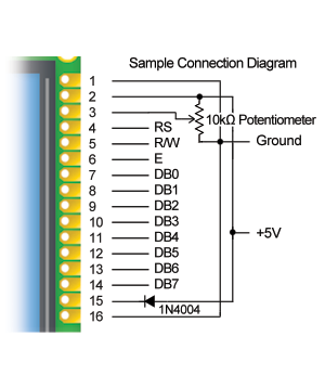

I purchased this LCD from Amazon.
And follow the intruction from its website and try the "HelloWorld" Example on Arduino
http://microtivity.utcdn.net/microtivity.com/IM161-1.png
I connect RS with pin0, Enable with pin1, RW with ground. DB4 with pin2, DB5 with pin3, DB6 with pin4, DB7 with pin5.
It is successful to run hello world.
I try the same connection on LabVIEW.
The extra configuration choice is "LCD". This is the power to LCD. So I connect port 15 with pin 6 through zener diode.
And set LCD to 6.
I got error code. No Helloworld. Is there anyone know how to solve this?
I checked out the configure VI inside. I don't know why should we set up LCD option. Why don't directly wire the "A" on LCD to power?

To me it looks like the pin connections you use in your initial test are not compatible with LIFA.   Labview uses digital pins 0 and 1 for serial communications with Arduino.  You can't use pins 0 and 1 with the LCD when you use LIFA..   The front panel for the LCD examples shows the digital pins that the designer of the VI used.  I recommend you use the same pins with Labview.

Thanks for your reply. It makes sense. But what is the Configuration LCD pin? What if I connect it directly to the power supply?
(5,266 Views)
Aha. you are right. LCD pin doesn't matter. I try two ways. Connect to Digital Pin or wire as instructions. Both could work
Thanks man

The front panel control labelled "LCD" is for the display's backlight.   Wiring the display's  backlight piin to either + 5 or a digital pin set high means in both cases you are essentially setting the display's backlight pin to the same value.  This is consistent with your observation.
