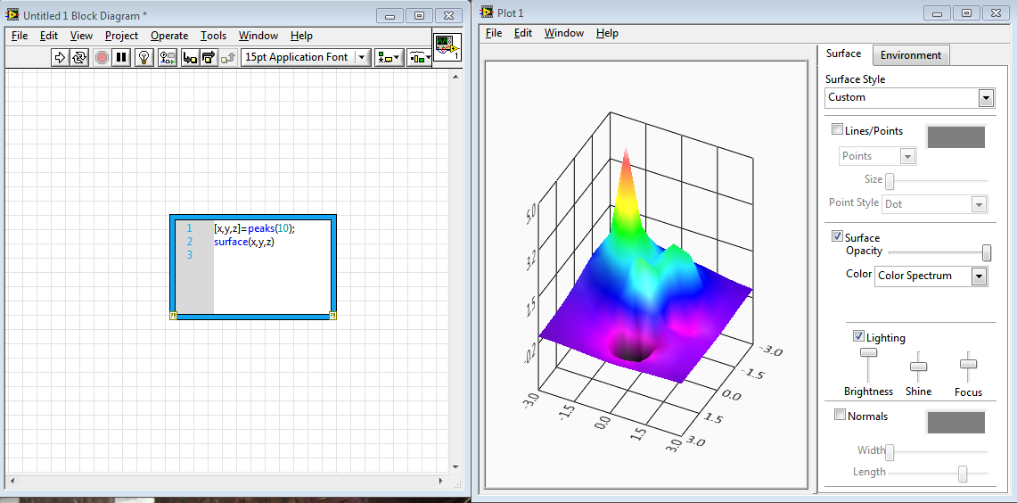

Is the LabView 'plotf_surf' function equivalent to the MATLAB's 'surf' function?
(12,354 Views)
Hello hykwei,
to your question
Question2:
If you are looking for an equivalent for "surf", you would want to use "surface" in MathScript.
plotf_surf plots a function of two variables as a 3D surface
surface  plots a 3D surface based off x,y,z matrix that you specified.
