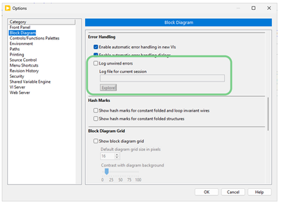

[2025 Q3 Feature] Log Unwired Errors
In LabVIEW 2025 Q3, you have the option to record unwired errors in a log file, independent of whether you enable the Automatic Error Handling dialog to report them.
Known Issues
  1. The Explore button is the wrong style and remains “pressed in” after clicking it.
  2. The Log file for current session path doesn’t populate when you first enable Log unwired errors.
  3. The log may contain errors generated by VIs that are part of the LabVIEW IDE.
