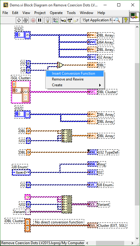

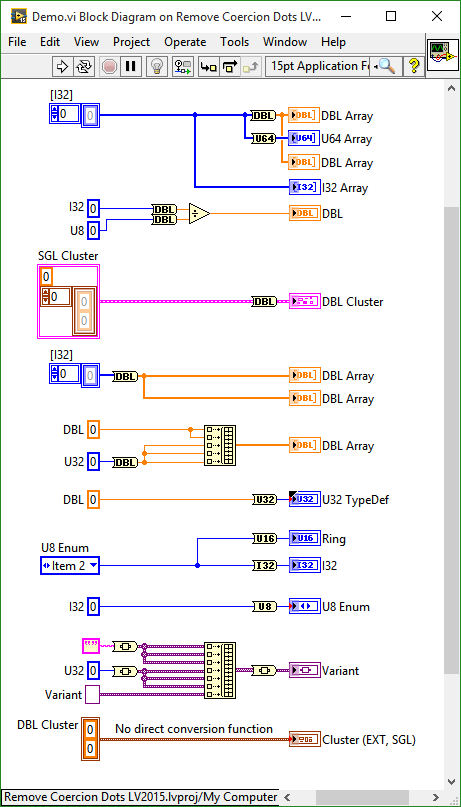

This plug in assists with removing coercion dots from you block diagram. It adds the option 'Insert Conversion Function' when you right click a wire or a selection that includes wires that has at least one destination terminals with a coercion dot. When activated it inserts the appropriated conversion function(s) based on the terminals with the coercion dot.
Before:
After:

- Now inserting one conversion function for multiple destinations of the same type
- Handling additianl functions where type depends on output and not connected terminal (Like Divide, BuildArray).
- Handling Enums and TypeDefs (not inserting when representation of source and destination matches).
- No more LV2013 support for Quick Drop Plugin (Wire:DisconnectTerminal method not available in LV2013).

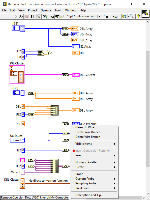

- Disabling menu options when no conversion function available for coercion dot. (Shown below on TypeDef wire)
