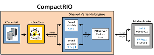

Modbus Slave I/O Servers
The SVE can use Modbus Slave I/O Servers to allow for communication with Modbus Master devices. When designing an application that will run a LabVIEW application on a normal desktop computer, it is not typical to use Modbus Slave I/O Servers. A more common application is to have Real-Time targets such as the CompactRIO configured as slaves with Modbus Slave I/O Servers set up on a CompactRIO’s SVE, as seen in Figure 14.
Figure 14: Using Modbus Slave I/O Servers with a CompactRIO
CompactRIO targets can be deployed remotely in place of PLCs and allow for integration into Modbus applications. The SVE and Modbus I/O servers support must be installed on the CompactRIO Real-Time controller. LabVIEW Real-Time can be used to access the physical I/O from the C Series modules then write values to Shared Variables. The Shared Variables are then bound to Modbus addresses using NI-PSP and Modbus Slave I/O Servers. LabVIEW Real-Time interacts with Modbus addresses through Shared Variables in the same way as used in Figure 16. This way many CompactRIO targets can be deployed as Modbus Slaves that all communicate with a single Modbus master over serial or Ethernet.

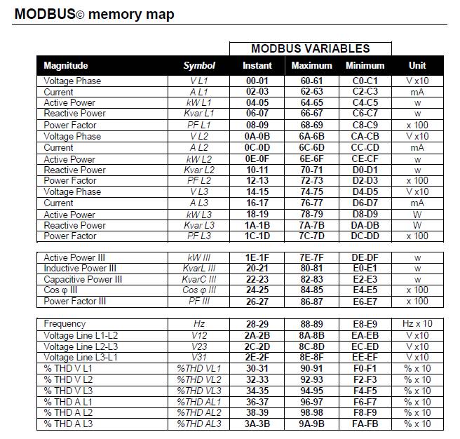

hallo kak Bian,
boleh minta tolong ? ni sy baru belajar modbus RTU, kok agak susah ya. dulu sy udah bermain komunikasi serial tp pake rs232c buat mantau suhu pakek mikrokontroler atmega doang, pembacaannya dari ADC ny doang kn gampang tuh.
nah dsni sy mau pake modbus buat baca metering. sy lampirkan manual meteringnya berikut
http://circutor.com/docs/M98172501-03.pdf
untuk memory map :
sy udah download ni visa, ni modbus library.
yang sy tanyakan:
1. brdsrkn apa yg sy ktahui ttg modbus dr manual metering tsb. modbus kan btuh request lalu alat tsb baru mau menjawab apa yang kita request kan ? nah yg kita request bentuknya hexadesimal kan, trus jwbnny juga hexadesimal. benar sprti itu ngga kak ?
2. kl benar, LabView bisa mengkonversikan ke bilangan desimal ? trus tgl kita edit jadi progress bar/meter/graphic maupun chart? soalnya dulu sy pke rs232c baca ADC datanya udah berubah jadi string, jadi mau di jadiin tampilan yg cantik gt gampang bgt. nah sy mau mempercantik tampilan dr modbus ini bs nggak ?
3. apakah converter yang hrus sy pakai sperti ini ?
udah tny itu dlu, mohon bantuannya kak, TERIMA KASIH

bian sudah tidak aktif lagi di labview, saya saja yang jawab ya:
--> ada dua cara, satu menggunakan NI Modbus Library, atau kedua, pakai sistem question-response, seusai dengan manual yang sudah sampeyan attach, halaman 34. Coba saya jelaskan yang question-response, berarti sampeyan akan menggunakan NI VISA Write (utk question) dan NI VISA Read (utk response).
Sementara untuk data yang ditulis dan dibaca, harus dalam bentuk hexadecimal (betul kata sampeyan). Gunakan String, dengan datanya dalam bentuk hexadecimal
--> betul, bisa. Tentu saja dari response yang dibaca, kan bentuknya Hexadecimal, ya dikonversikan ke bentuk numeric.
Ini contoh di manual halaman 34:
kita lihat yang:
00 00 08 4D
berikut ini konversi codenya dalam LabVIEW:
Output dari VISA Read pasti dalam bentuk String, jadi masuk ke fungsi seperti di atas, lalu dapat angka 2125, dan diubah saja menjadi 212.5

mantab kak, ada peningkatan tp beda sm manualnya, hasilnya seperti ini
tapi kok beda ya sm manualnya, mksdny susunannya beda dkit. itu read indicator sy jadiin display hex jg jd bngung urutannya gmn hehe,
sedangkan di manual seperti ini
trus mw nny gmn kak caranya misahin misahinnya, tu kan hasil hex nya bnyk bgt sy mau pisah2in (mana yg Volt, Ampere, Watt, Var, PF)  trus mw sy convert ke decimal
Message 8 of 30
(8,401 Views)
kak tuh hasilnya ? gmn caranya biar itu hasilnya misah satu satu kak ? mau sy convert ke decimal soalnya
Message 9 of 30
(8,401 Views)
Banyak cara, salah satunya dengan "String Subset" di string function pallete.
