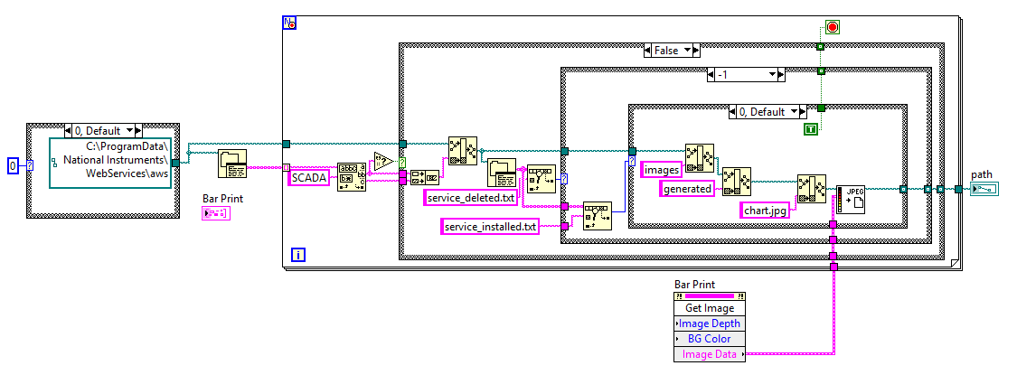

Sorry i am not sure how to attach vi here so i snapshot the program which i use to put into the webservice folder. I will put into the folder which with service_installed.txt and without service_deleted.txt. In my webservice code, image directory code will be “ /SCADA/images/generated “ . This is working with no errors. But the problem I having now is some of the webservice folders didt contain service_deleted.txt and cause me putting the image into wrong folder. I do not know how to determine which is the folder that actual running the webservice

Hi,   Its difficult to solve the problem without the code try to replace the scada with any other name . Cause the aws folder  consists of many scada folders                                             (or)  You can attach your code by clicking the " Show Full Editor" in the top Right corner  in the Reply   Regards, Krish.

        The SCADA webservice folders are automatically created by LabView application. Once your application having webservice function, these folders will be created. It will created when the application is started to run and this new created folder will be the actual webservice folder. Prior to the new folder creation, a service_deleted.txt will be inserted into the old webservice folder. So previously i scan each folders which didt contain service_deleted.txt and that folder will be my target folder to put my image. The problem is, some time the service_deleted.txt didt written into the older folder so i get the wrong folder as my target.
          Now i solved the problem where i get the folder creation time instead of scaning service_deleted.txt. The newer creation time folder will be my target folder This forum post helped me on this (http://forums.ni.com/t5/LabVIEW/file-date-created/m-p/109836?requireLogin=False) .By the way, thank you for trying to help me
