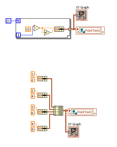

Here are two examples of building a point array (for an XY Graph) that can be used with Data Dashboard:
The top example is y=x^2 from x=-10 to x=10, illustrating what you might do if you're using a For loop to construct your data.
The bottom example is more simple: The result is just an XY Graph with a line connecting 4 points: (1,2)   (2,4)  (3,6)   and (4,8).
The issue with your first screenshot (Capture.JPG) is that you're taking two arrays of numeric data, and bundling them into a cluster. (So, a cluster of 2 numeric arrays).
Instead, what you should use is a single array of data, where each element in the array is a cluster of 2 numeric values.

Malcolmsmith solution is the one that worked for me in the set up.
Thanks for the help.
