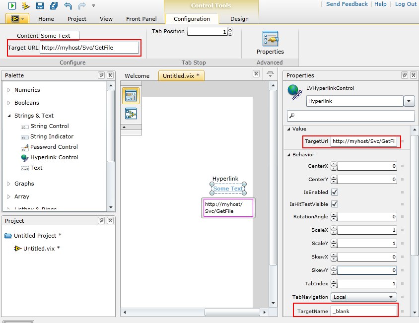

I'm attaching an editor screenshot for configuring the hyperlink - can you confirm that your control has all of the red boxed properties set up correctly? Another possibility is that you put the URL in the "Content" (link text) rather than the Target URL, then nothing would happen when you clicked it.
