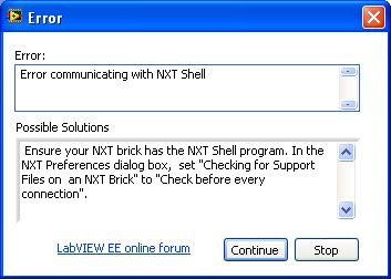

I have a small project which aim is: to control NXT motors by LabVIEW application with bluetooth connection. To this end and to test possible solutions I have used following files: http://decibel.ni.com/content/docs/DOC-11110.
I can:
1. connect to NXT through bluetooth
2. upload NXT client (Deploy) and run it through bluetooth
I cannot:
1. Control NXT motors even NXT module is running by use bluetooth
I usually get following message: "Error communicating with NXT Shell" (http://forums.ni.com/t5/image/serverpage/image-id/23722i52D00D5FFE31ACEA/image-size/original?v=mpbl-...)
I would be grateful for any suggestions.

Dear cabal23,
thanks for your question and sorry for the late reply!
I would like you to clarify a few things first:
1. Did a similar error occur in a different circumstance? E.g. did you try to deploy a different program and communicate with it successfully?
2. Did you set "Checking for Support Files on an NXT Brick" to "Check before every connection" in the NXT Preferences, as suggested by the error message? Did something change?
3. Did you run the host VI after running the client or the other way round?
Thanks for the answers and looking forward to hearing from you again.

Dear Zenon,
Thank you for you response.
Here is the list of my answers:
1. Described application (http://decibel.ni.com/content/docs/DOC-11110) is my second attempt to work out problem of controlling NXT motors through bluetooth. At the beginning I tried to start following application: http://www.claytonmcneil.com/pages/contentpgs/BT_Motor_Control_via_Distance.htm. It was much more problematic for me so I found mentioned http://decibel.ni.com/content/docs/DOC-11110. Answering to your question: I tried two program and I could not start any of them. I am very beginning LabVIEW and NXT user.
2. Yest, I set "Check before every connection" in "Checking for Support Files on an NXT Brick" section.
3. Described in the previous message error "Error communicating with NXT Shell" (http://forums.ni.com/t5/image/serverpage/image-id/23722i52D00D5FFE31ACEA/image-size/original?v=mpbl-...) occurred when I run, as first, NXT client (NXT_drive.vi file) and then PC host (PC_drive.vi file).
Taking your third remark into consideration I run program in the other way i.e.: I run PC host first. As a results I can see on NXT screen: "NXT Shell version 2.0; Sensor View ->".  But, I have no idea what is the second step and how to run NXT client program.
I look forward to hearing from you soon.

Dear Cabal23,
I once again have to apologize for the late reply.
I believe it should be enough just to open the NXT_drive.vi in LabVIEW and load it onto the NXT brick using the down arrow: nxt-down-arrow.png. It should be next to the Run arrow. Then you can press the Run button on the NXT brick. But I understand you already tried this, did you? What happens if you first run the Host VI on the PC and then you deploy and run the application?

Dear Mr. Zenon,
Thank you very much for your help.  As I figured out there was no problem with Bluetooth drivers. Probably the problem was caused by used program to control Lego motors. I found other program for LabVIEW (http://www.legoengineering.com/) and any trouble was occurred.
As it can be seen it is very important to use right examples at the beginning of learning of new tool.
mir
