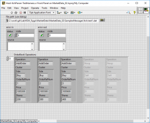

Here is a screenshot of the Front Panel diagram for the ITCH Parser Test Harness:

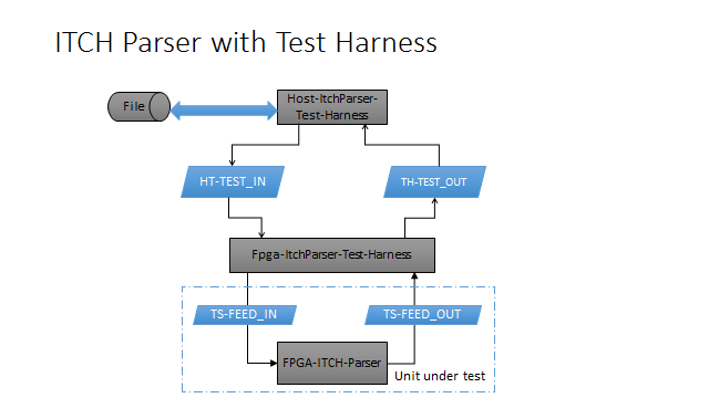

and here is a flow chart of what is going on:
What exactly is going on? The vi Host-ItchParser-TestHarness.vi, reads the file containing raw NASDAQ ITCH Market Data messages, sends them in to the FPGA Test Harness via the Host-to-Target DMA FIFO “HT-TEST_IN”.  The Fpga test harness is located in the “Tests” folder and is named “Fpga-ItchParser-TestHarness.vi”, this Test Harness passes the raw Itch data as is to the Fpga-ItchParser.vi, which parses, normalized and filters each message for Add order message types only for symbol AAPL. It then sends an OrderBook command for each appropriate message back out to the Fpga-TestHarness which sends the results up to the host

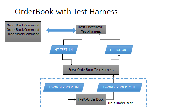

And for the OrderBook Test Harness

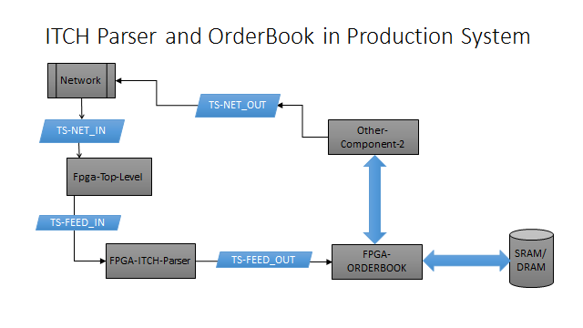

Here is what it would look like in a production system
