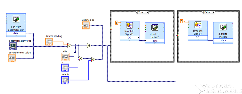

My mistake, think this is just a Labview question.
Here is my latest VI, I took your suggestion for case structure and came up with this. image.pngimage.png
This seems to be working well, but I get the following error when my case switches from True to False or vice versa:
"The specified resource is reserved. The operation could not be completed as specified."
I'm presuming I need to stop the execution of one case and THEN begin the other when doing the switching? Can you guide me further in the right direction, thanks.

When you attach a picture rather than a VI , we can't inspect the hidden things. like the details that are hidden in an expressVI.
Do you need a "Simulate Signal" for a DC value?
You can't start two different tasks that talk to the same device.  That is why you have a reserved message.  You didn't give the actual error number, but my guess is that it was -50103?
Create one task that has both outputs.  When True, write a 5 to port A and 0 to Port B.  When False, do the opposite.  The actual Express VI will be outside the case structure.  The only thing inside will be the values.
Better yet, learn how to use the actual DAQmx VI's and get rid of the Express VI's.

If you are doing a comparison, that implies 2 inputs, that doesn't mean 2 outputs.
You should be figuring out how to spin the motor in forward and reverse using a single output, what your original thread was about.  Once you can reliably spin the motor using a simple VI, then you worry about complicating.
