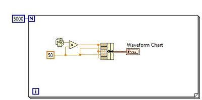

yes 192 no of Waveform chart and each chart contains 5 different plots..in it.
i have kept chart history length 12000
images just shown for only one waveform chart..

Hi AtulS,
memory per chart: 5*DBL*12000=60k*DBL=60k*8B=480kB
192 charts with the same amount of memory: 192*480kB = 92160kB ~ 92MB
From the raw numbers this should be ok, BUT we don't know how many data copies you made in your VI.
And handling 192 charts in a single FP is pure non-sense!
I agree with Christian: rethink your UI design…
