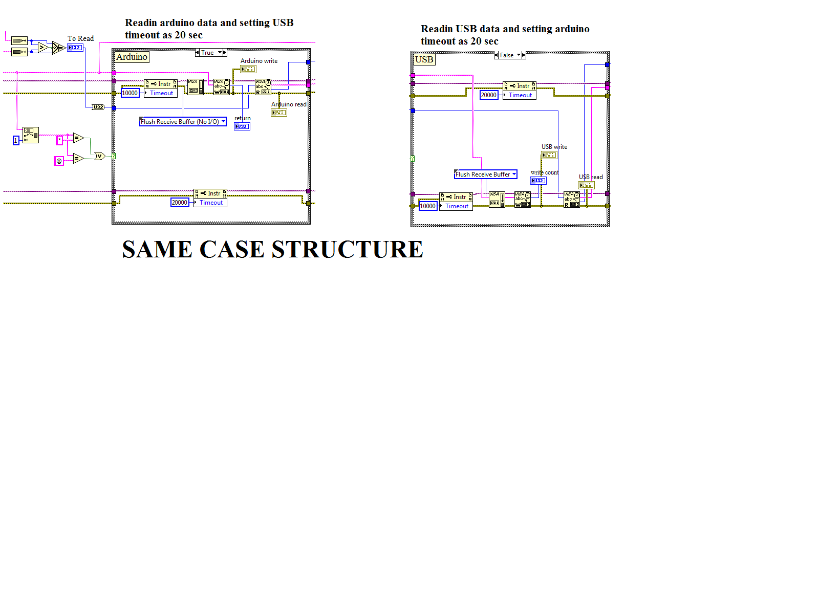

Can you post an image of the block diagram?
Also, since you moved to a different os, check the versions of the usb device drivers.

He is not using a PC/Laptop but still trying to help you out. If you can post the image of your code (Try to post different images of the complete code), you will get the benefit.

It explains why I asked for an image and why I can't open your VI. If you don't want to, fine. I'll bow out of this thread.

For the arduino, are you using either LIFA, the newer LINX, or a different sketch? Is it always plugged in? What about the other USB connection? Is it always plugged in?
As far as the code, it should not be necessary to always change the timeout. I also don't understand the need to always flush the buffer.
I still think you need to check the Windows drivers for both the arduino and the other device.
