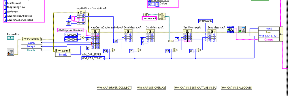

Ok, this is one of the strangest LabView programs if've ever seen - but this dot.net stuff works, somehow.
On all 3 Laptops tested, the original .vi was running smoothly displaying a nice color-image when started for the first time, but if I had stopped it, and tried to run it again, I only got a black screen displayed.
I could only re-run succesfully after re-starting windows. each time.
-_-
That is why I have re-written McArthur's vi:
The .vi attached does capture images - or rather a video-stream - from the built-in cameras of an Asus Laptop running Windows 8.1 and a HP Laptop running Windows 7 and even an Acer Laptop running Windows Vista Home Premium - each time I used the Laptops built-in webcam to capture images.
I'm a bit puzzeled for the folowing reasons:
0# the picturebox is outside the while-loop, instead of being inside the while loop hurting our beloved data-flow paradigm - but, ok, I guess I can cope with this exception
 the picture box is displaying and refreshing images, if the first itaration takes some time e.g 1000 ms - okay that's cool, we all need our time, but...
1# the picture box is displaying and refreshing images, EVEN IF the while loop stands still in iteration 2
2# the picture box won't refresh if you leave out the "this part reshreshes the picture box"-part hi-lighted in the snippet/vi with the black rectangle.
3# even stranger: if I don't put all the .dlls in the while loop, I get a behavior as mentioned above: first run ok, re-run = restarting windows
If attached a version converted to LabView 2010
Alex

The picture box does refresh itself (displays new images) even if the while loop is not executing.
But during the first Iteration, four HEX values (U32) have to be written in a certain order to user32.dll
I have been asked about the meaning of those HEX values.
x040A, x0435, x0434,  x0432
Well, according to msdn those HEX values must be Application-Defined Messages
"Values in the range 0x0400 (the value of WM_USER) through 0x7FFF are available for message identifiers for private window classes."
And empirically:
x040A, x0435 ... start the image stream and display first image
x0434, x0432 ... refresh displayed image

Those "magic" numbers are Video for Windows message identifiers. The VfW capture interface is  really a background window that handles all the interaction with the VfW capture drivers (nowadays there really only is one, the Direct Draw to VfW Bridge that translates all Direct Draw sources into VfW capture sources.
And the way to control that VfW manager window is through these messages. As it is a dedicated window it can use whatever message indicators that are reserved for the private user range. Only this window knows about these message identifiers and reacts in the documented way, any other window in Windows will either not understand the message at all or do something entirely different when receiving one of these message numbers.
MSDN describes the Video for Windows interface here. But it is not available anymore by browsing the selection tree, as Microsoft doesn't really want anyone to use this interface anymore as it is really a Windows 3.x technology that got obsoleted by Direct Draw in Windows 2000 or so and only exists for backwards compatibility and might get axed at the first real problem, rather than trying to spend a single man hour on fixing a problem in it.

https://forums.ni.com/t5/Example-Code/Video-for-Windows-avicap32-dll/ta-p/3491285
I think I found the msg meanings. The original source code could be found via this Link
It follows
WM_CAP_START = 0x400;
WM_CAP_DRIVER_CONNECT = WM_CAP_START+10 = 0x040A;
WM_CAP_SET_PREVIEW = WM_CAP_START+50 = 0x0432;
WM_CAP_SET_PREVIEWRATE = WM_CAP_START+52 = 0x0434;
WM_CAP_SET_SCALE = WM_CAP_START+53 = 0x0435;
Thank you for your kindly reply.
Best Regards,
Yours Dylan Zhong
