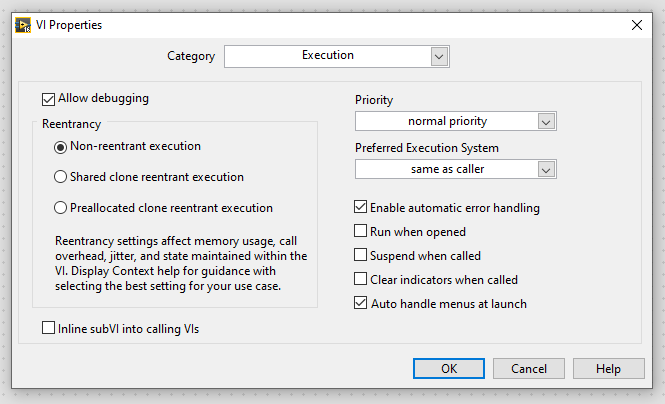

Since you are also expecting data back, you should probably make a non-reentrant VI to send the message and read back the response.  Then the VI will act as your semaphore/lock so that only one instrument will be allowed to talk at a time.

this sounds good, yet I have no idea what a non-reentrant VI is.

Reentrancy is a property of each VI. The default is non-reentrant, meaning if 2 places try to call it at the same time, one will get it first and when it is done the second place will get it. You can enforce which one call gets run first by making use of dataflow. You can use shared clone if everywhere the VI is called the history has no impact. You can use preallocated clone if you want each place the VI is called to have its own memory space. So if you are using, for example, feedback nodes, the history will be kept intact for each specific call of the VI.
