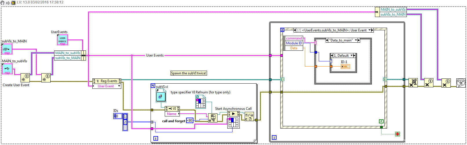

I really like to use UserEvents to communicate between subVIs and a main VI. Here you will find a nice quick tutorial about Events:
http://www.walkingthewires.com/2015/07/20/something-happened-events-in-labview/
I just put together a small very draft example how to launch two clones of the same subVI, but with different ID values (beside this, you can also feed in different COM ports, device IDs, etc...). I used strings for commands to be quick, but some people prefer Enums for case structures.
Anyway, I hope this example will give you some idea how to do this intercommunication using Events. I attached the mini project as a zip file (LV 2013 version).

THANKS FOR YOUR EFFORD. Just what I need!
I will start looking at your example at once, and might return with questionsSmiley Very Happy
