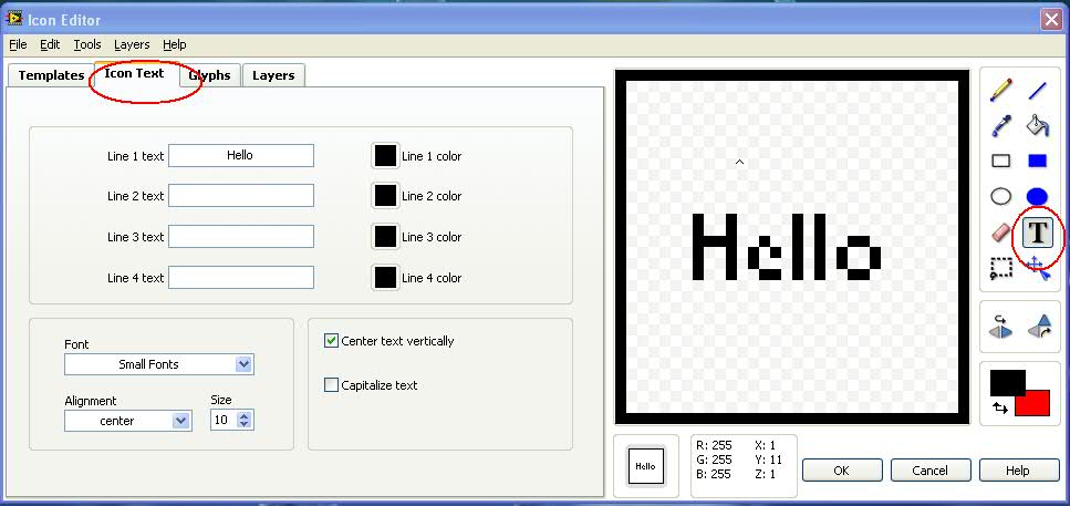

Again maybe I'm missing some thing but you can choose different fonts from the old and new icon editors.  In the old one double click the text tool (the big A). And in the new one on the Icon Text tab in the lower left there is a Font selection and it has the option to choose any font that is installed on your OS, including "Small Font" which is the same as the default one in the old icon editor.

1. I didn't really understand what you meant by this. The icon editor seems to change fonts for me.
2. A little analysis and I think that the old Icon Editors font is Name: Small Fonts Size: 10
Are you actually using Eastern Language Settings as suggested by ttrr? If no, I would like you to please elaborate on the problem. It may help us uncover the problem.

I think I've figured out what you meant Jspaarg.
Did you mean that when you use the Text Icon in the right hand side, you get a different font? I don't think thats a bug really. 🙂
You should use Icon Text Tab and change the font to Small Fonts Size 10 to get the old font. Again, I'll attempt to reconfirm the font.

The recommended and default font was and is Small Font, size 9.
The font settings on the icon text tab are only used for the inputs in line 1 to 4.
If you use the text tool, either double click the text tool or go to  Tools->Options to change the text tool settings (font, size and position).
The IE in 2009 does not expose the options bold or underlined text.
