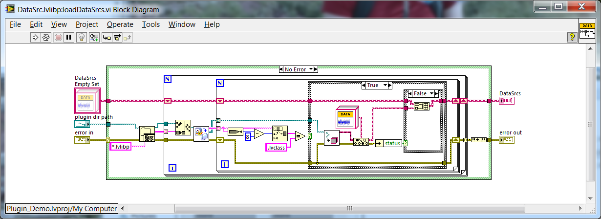

As for the the DataSrc.lvlibp, it  really isn't that exciting. There is a DataSrc.lvlcass which has two empty methods since it is basically an abstract class or interface class.  The two empty methods are readName.vi which is intended to return a unique string for each plugin and readValue.vi which takes a timestamp input and outputs a value.  It also contains the function loadDataSrcs.vi which I use to dynamically load the plugins which are all child classes of DataSrc.lvclass that override the parent methods:

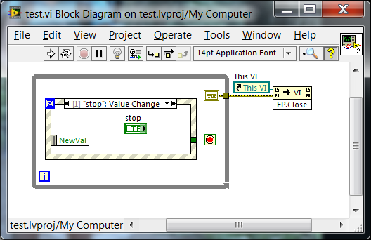

I have reduced my code to almost nothing being present, and the problem is still there.
This is what I have left:

And if I take my executable and place it on another computer... it works fine...
*sigh* Seems like my LabVIEW may be messed up somehow.  Will try re-installing.
Message 9 of 11
(6,818 Views)
If that simple code doesn't work something is really borked. Maybe something in LV memory since earlier. Does restarting LV and/or computer makes a difference?
