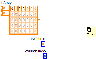

If you use Index Array one a 2D array, and you enter only ONE of row or column (not both) then you will extract that vector as a 1D array.
(7,588 Views)
As a recent example, look at my image posted here. It gets the second column as a 1D array. You would wire a zero to the lower index, leaving the row index unwired. This will get you the first column.
All this is explained in the help.
