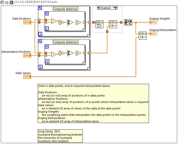

The problem with extrapolating is that the results are unconstrained - unless you impose some expectations, which is what is part of the fitting process.  A low-order polynomial fit will tend to maintain derivatives at the boundaries of the input region, but even a cubic can easily diverge very quickly from the input data.
There are ways to inter/extrapolate without fitting though.  One method I use is a Kriging interpolation, which is also reasonably well-behaved outside the input data, and works for an irregular spacing of input data points.  There are a lot of possibilities for imposing constraints on the mapping (have a search for Kriging and variograms), but the most simple approach is to just use weightings of the distance to the input data, which tends towards the average of the input values as the distance gets large.  I've posted about it before: http://forums.ni.com/t5/LabVIEW/2D-array-or-3D-array-interpolation-need-help/m-p/1681014#M598046  In recent versions of LabVIEW (2011+ I think), the Interpolate 2D Scattered function using the Greens method uses pretty much the same approach, though I think has problems with two data points at the same location (i.e. distance=0 between them).
