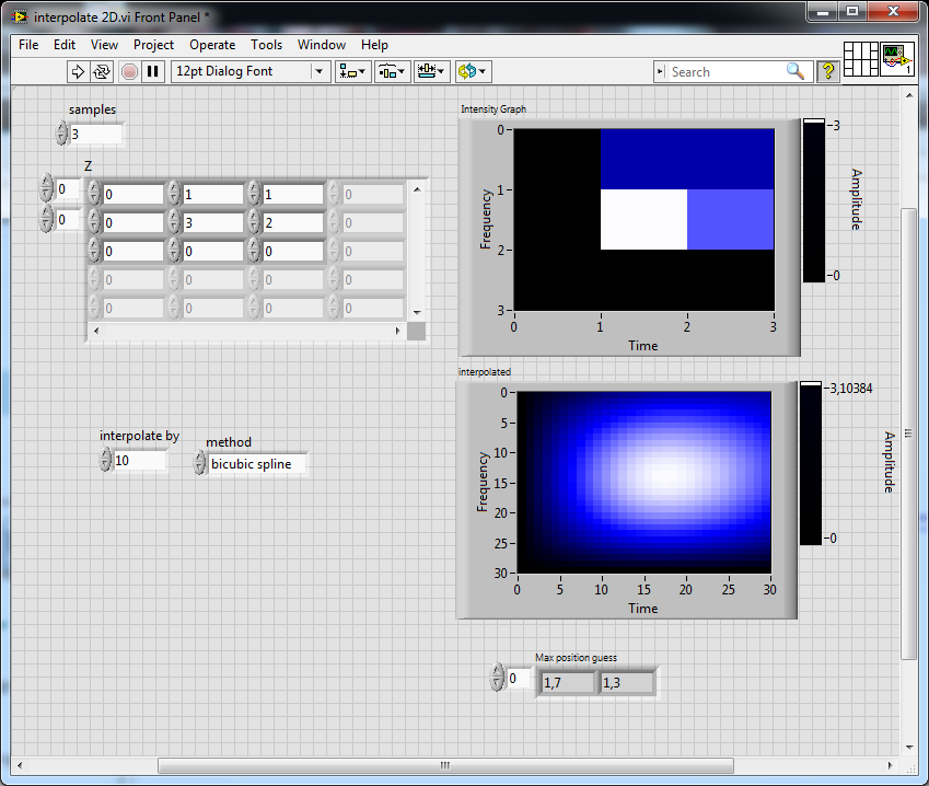

I add another interpolation vi...
nothing fancy... it was written and posted in thread that was deleted ...
the task was, to make a guess of a heatsource position with a given temperature sensor array
(and some hint how to solve that for more fingers/heat sources )
Greetings from Germany
Henrik
LV since v3.1

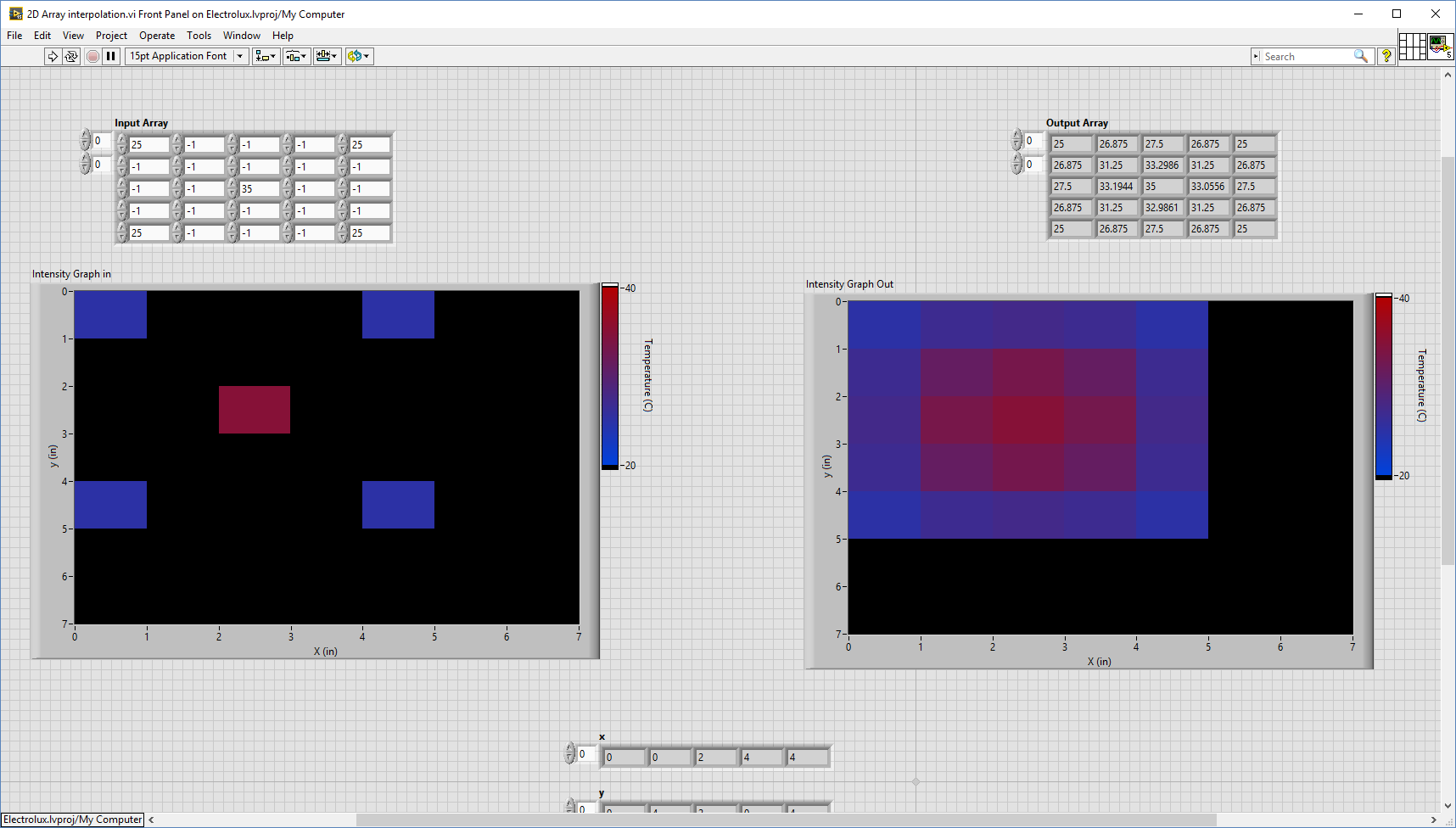

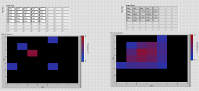

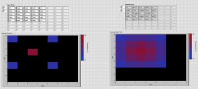

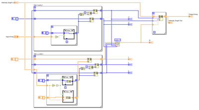

I have a problem when using this 2D Array interpolation.vi. It fails for some cases, where the missing data points are on the edges.
here all fine 🙂
The vi is more or less exactly the same like the one uploaded here.
The locations of data points and missing data points fed into the Interpolate 2D scattered.vi is found correctly. That is why i`m not sure what else could be wrong. Any idea? Thanks in advance ^^

Hi becker,
Where does the VI "fail"? It still produces an output so it gives no error.
I would even say it produces the expected output!
Why don't you attach the VI?

It should replace all the NaN pixels with interpolated ones. So in my interpolated result i don't want any NaN pixels.
Message 16 of 18
(3,460 Views)
Hi becker,
Using "cubic" interpolation you cannot interpolate outside of the defined area, so the interpolation function will give you NaNs as shown in your images.
You might switch to the "Nearest" interpolation method to remove all NaNs. (Or you implement a combination of both methods: Use "nearest" only for those elements, where "cubic" results in a NaN value…)
(Btw. by using conditional tunnels you could simplify this somewhat older VI.)
