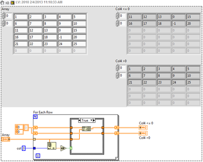

Here's a brute force method:
(4,344 Views)
With a conditional tunnel (LabVIEW 2012 or later) the code fits on a postage stamp.
(4,335 Views)
