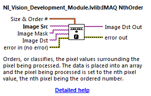

It is there - IMAQ NthOrder under Image Processing:Filters.
By default, it takes the middle number of a 3x3 region around each pixel, but can be set to be the largest, smallest, or any rank in between.  Also has the flexibility of defining the size of the filter, although being a non-linear filter (hence why it's not separable as you suggest) the time required increases significantly.

Excellent find.  Further information on this fx:
"You can use this VI to apply a median filter by selecting the correct order, (f^2-1)/2, where f is the size of the convolution matrix." (A median (center-pixel) operation is advantageous because it standardizes the gray-level values without significantly modifying the form of the objects or the overall brightness in the image.).
So one only needs to specify the convolution kernel dimension, and can use the above equation to calculate order.  It was hard for me to believe that Vision did not have this function.  I now see that I should have searched the NI Vision for LabVIEW Help.  This is something I almost always do in addition to searching for the actual functions from the block diagram.  Had I done this, I would have found it.
