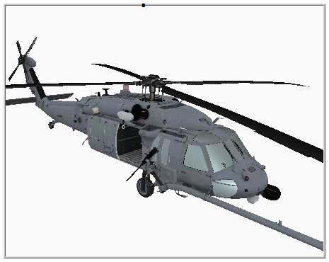

Just to let you know that you can use the Haro3D library (free from NI Tools Network) to upload .stl models and have the normals automatically calculated. You can also upload .obj models with texture (as shown below).
Hololens_OBJ_Helicopter (no Hololens)_FP.pngHololens_OBJ_Helicopter (no Hololens)_FP.png

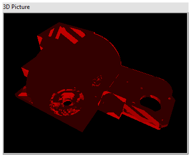

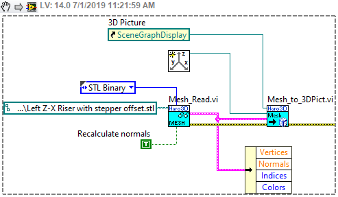

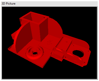

Yes, the Mesh_Read function has an input to recalculate or not the normals.
When Recalculate normals is true:
When it is false:
