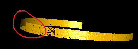

The lightning seem right, but I do get object further away shining through the front objects. Didn't have that with the duplicated data set w\ culling:

Interesting I hadn't noticed that error...
