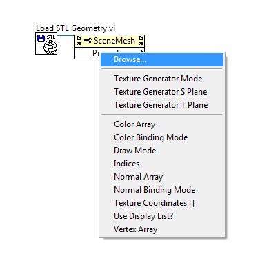

But the reference that comes out of the Load STL file can also be used to get the properties of the model like this:
Hopefully the items in the list do ring a bell for you. I think you can use the data which you retrieve from these items to implement what you want to do but again, I am not into the 3D modeling it self so take a look at that part your self and If I can be on any help for for functions use in LabVIEW please let me know!
