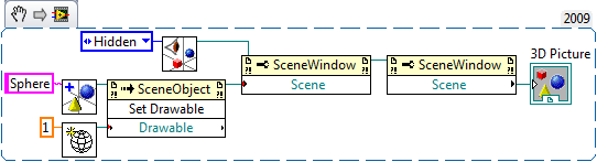

You tried to following already... don't know if it will work however but maybe you can notice a difference.
20761i5E715CBF140559A8

Thanks for the suggestion, Eric, but I don't think that it is possible to insert the 3D picture SceneWindow into a subpanel. But I will do some playing around to make sure.
