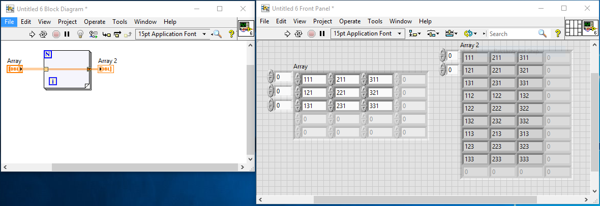

Something like this?
(5,590 Views)
StephenD showed you how to change a 3D array of 3x3xmany into a 2D array of (3*many)x3 array (the third-dimension's 2D arrays are stacked vertically).
If you have the Report Generation Toolkit, generating an Excel .xlsx file containing such a 2D array is very simple.  You use New Report (specifying Excel), an Excel Easy Table (with the 2D array wired to its 2D input), Save Report to File (to which you've wired the path to the .xlsx file you want to create -- don't forget its extension) and Dispose Report (to close Excel).
