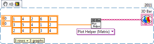

In 2011 number of graphs is determined by number of rows in matrix you send to it
3dbar.png.

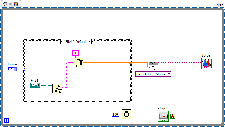

Hello id,
I think this VI can be usefull for you. Take a look at it.
David
