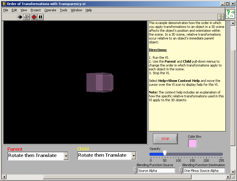

Got that working but......
When I modify the  "Order of TRansformations" example to make the boxes transparent (or partly transparent) I can see the Parent object through the child object but not the other way around.  While the parent cube seems transparent in itself (I can see front and back sides) I cannot see the child box when it is behind the parent box.
Is this by design? Do I need to set different parameters?
Child box in front.PNG Child box IN FRONT of parent box - visible
Child box behind.PNG Child box BEHIND parent box - not visible
Shane
Message Edited by Intaris on 07-02-2009 06:10 AM
(4,575 Views)

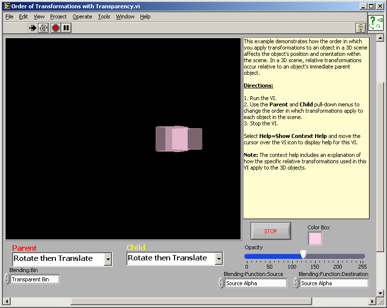

Well I have to say that I'm having a great chat with myself here.....
I figured out the importance of the "Blending.Bin" property.  Setting the parent object to "Transparent Bin" solves the problem.
Shane.
Message Edited by Intaris on 07-02-2009 06:22 AM
