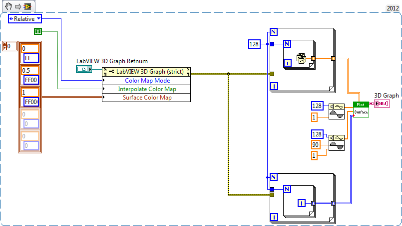

Note the optional input for the colour matrix. Wire in a 2D array of intensities that matches the dimensions of Z, and you'll see that the colour now changes accordingly. With some access to the properties of the plot, you can change the colour map, the interpolation mode etc etc. Here's one I made earlier:
The 3D Graph property node can be created by right clicking on the control and heading to Create > Property Node, and then adding the desired methods. The data wired is arbitrary - I generate a sine and cosine pattern for the X Y arrays, a Z array of ramps from 0 to 127, and a colour array of random doubles. The array of clusters wired to Surface Color Map are my colours, and I've changed the integer value (for colour) to a hexadecimal so I can use my beloved RGB. So my colour map is:
0 -> 0000FF (Blue)
0.5 -> 00FF00 (Green)
1.0 -> FF0000 (Red)

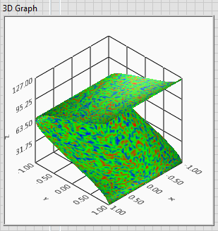

The result?
I believe that's what you were after.

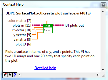

Point is, that the VI you are using is not directly accessable in LV 2013. LV 2013 drops the "Plot Helper.VI" which doesn't provide the color matrix input instead of the "create_plot_surface.vi".
Therefore, with LV 2013, your recommendation is possible, but not obvious (nor easily accessable).
@Op: If you want to use this approach with LV 2013 without going through thoult's snippet, you have to place the create_plot_surface.vi manually and replace the Plot Helper with it.
You cannot find that VI on the palette, but can "Select a VI..." and browse to <vi.lib>\Native 3D Graph\merge.
On my machine, the complete path would be C:\Program Files (x86)\National Instruments\LabVIEW 2013\vi.lib\Native 3D Graph\merge.

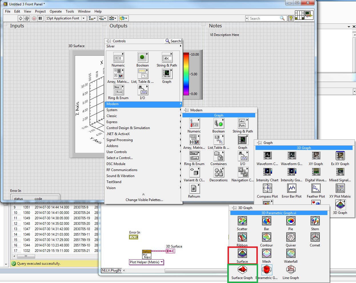

Hey Norbert,
Have a look at the following screen grab from my front panel. That plot helper is dropped automatically using Surface Graph, whereas the one without the colour matrix is just labelled Surface.
Not sure why there's a difference between the two.

Good catch. Never dropped the "Surface Graph"...
The difference is that "Surface" is using an XCtrl which is derived from a graph and exchanges the traditional 2D coordinate system with a 3D picture control (including all nice MESA stuff for zooming, rotating and lighting the scene).
The "Surface Graph" uses an XCtrl which is derived from the 3D picture control, so you have no color ramp and "helper buttons" availbale. But indeed this one grants direct access to the "create_plot_surface.vi".....
Norbert

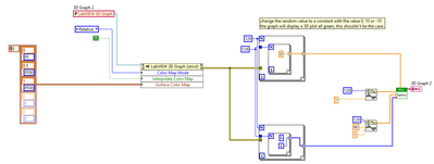

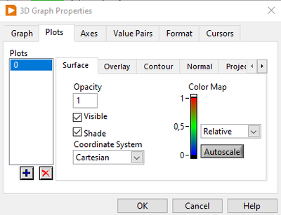

I'm trying to use your code but discover a problem. I tried to change the random value by a constant 0 or 1 to display the same color for the plot. When I do this, the surface graph always display the same color which is green. But when i look at the color map for 0 it should be blue and for 1 it should be red. You will see my code below :

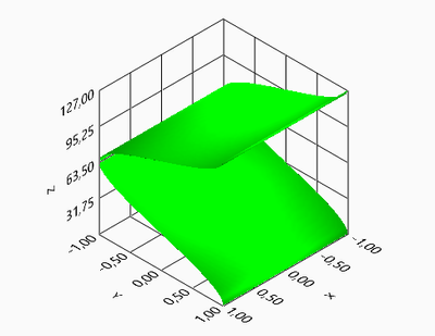

This is really simple, in this case the plot should be all blue but I obtained a green plot as follow
When I look at the 3D graph properties, I have the correct color map with blue (0), green(0,5) and red (1).
It seems that it follows the color but not the value associated with it. Looks like it changes the Minimum and Maximum and calculates the average of the color matrix that I'm sending to it to display the graph.  the surface graph is not using the color map surface that I'm sending to him.
Do you have the same behavior ? Is it normal that the graph runs like that ?
I'm using LabVIEW 2020 - 32 bits on Windows 10.
