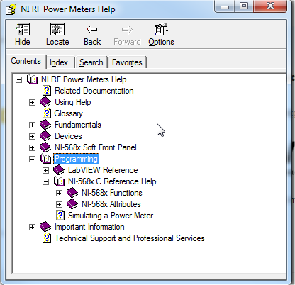

I've debated this enough with myself.   I need the programming manual for the 5681.  I will write my own VISA driver to make this a positive experience for my client.
(Darn it, I really hate it when some text coding weenie messes with my LabVIEW mojo!)
Message 9 of 13
(4,356 Views)
Hi Jeff,
I reproduced the behaviour you were observing on my end and I have created a CAR (corrective action request) #406711  for 568X R&D driver team. So far I cannot give you a timeline on when the fix for this will be implemented. Now, as far as programming manual is concerned refer to RF meter help file.
