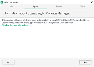

I recently tried to install NI DAQmx 20.7 but I cancelled when I saw this:

It's the MDF 20.7 or newer that gets installed with almost all NI 20.7 or newer software components. This Meta Deployment Framework is the shared software component that is used by all product builders, be it the LabVIEW Installer Builder or the LabWindows/CVI Builder, or whatever else can build installer packages such as NIPM.
https://knowledge.ni.com/KnowledgeArticleDetails?id=kA03q000000YOE0CAO

If you are building the older style of deployment (not using NIPM), then the KB that Rolfk posted above tells you how you can edit .ini file post-build to allow the installer to run on Windows 7 / 32-bit. However, keep in mind that you cannot include any newer drivers that have dropped support for these older OSs, as they may not longer function (such as if 32-bit kernel DLLs have been removed or if the driver signing requirements changed).
