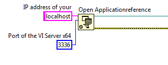

The first point you mentioned is dynamically load an x86-VI within x64VI: This could be approached through configuration of the VI-Servers of the two LabVIEW Versions, working on different network ports. Therefore you need to determin your VI Server settings (Tools->Options->VI Server), for example your x64 (x86) shares data through the TCP/IP Port e.g.: "3336"
If you are calling the VI by reference you also need to open an application reference to the VI Server and then use open VI Reference VI to open the specific VI you want to call:

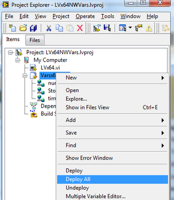

The important thing is, that before you could use the Variables you have to deploy them, therefore you have to right-click on the lvlib in the project and say Deploy All, demonstrated in the picture below.

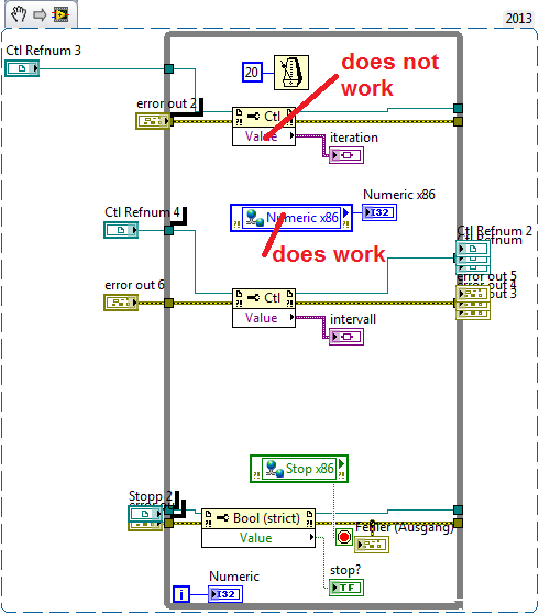

Using Comrade's example pairs (LVx86.vi and LVx64.vi) I was unable to read the x64 indicator values in the x86 application using the property node Get Value called in LVx86.vi (snippet extract below). But the shared variable access mode in LVx86.vi is working nicely. With Get Property no new data is delivered - just zero, but again - no error is reported - any idea why?
But in any case thanks to Comrade for a useful example.
PS: using LV2013's
