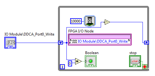

So lets see if it likes this:FPGAVI.png
So the rest of my message was:
It compiles and runs, the boolean flashes, but I can't find a signal on the breakout boards anywhere (i.e. the IO pins)

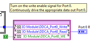

Take a look at the NI 6581 Continuous Generation - External Clock.lvproj in the example finder.
Hardware Input and Output>>FlexRIO>>IO Modules>>6581
It demonstrates how to write to a port. You'll notice that after configuring the module, it provides a true value to the Write Enable IO node for Port0.
